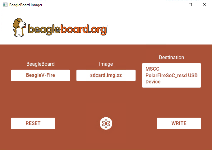

BeagleBoard Imager#
With BeagleBoard Imager running, work your way from left to right, like so:
  1. Select board. This one’s obvious.
  2. Select your image from above.
  3. Select your drive. This one is critical to get right; see below.
  4. Click WRITE and watch it go!
BeagleV-Fire: This is how the BeagleBoard Imager should look when ready
With a little luck, all goes well and BeagleBoard Imager reports no errors.
In that case, you can close out BeagleBoard Imager and disconnect the USB cable.
On the next power-up, your Beagle will boot up the new image and you’re ready to rock!
