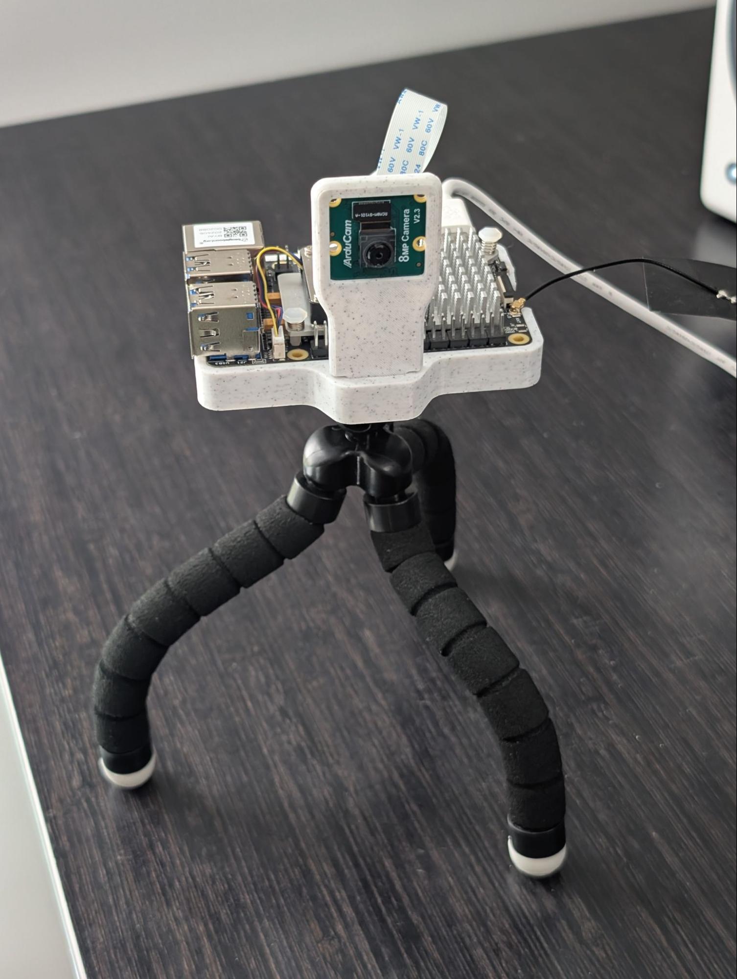

A camera, and a few other additional parts are needed to run Edge AI demos. Optionally, a 3D printed mount can organize the components onto a standard camera tripod with the sensor oriented forward.
Fig. 153 IMX219 CSI camera module + 3D printed camera mount#

3D printed camera mount  |
(Optional) For orienting Arducam IMX219 module forward. Download design on Printables.  |

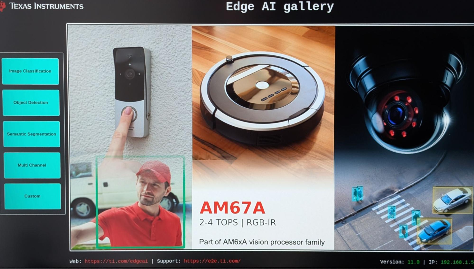

If you haven’t already, plug in a compatible HDMI display + USB mouse, and boot the device. After ~10-20 seconds of boot, you should see the following screen:
Fig. 154 Edge AI boot screen#
Note
Display port alternatives to HDMI like OLDI/DSI might work but have not been verified.

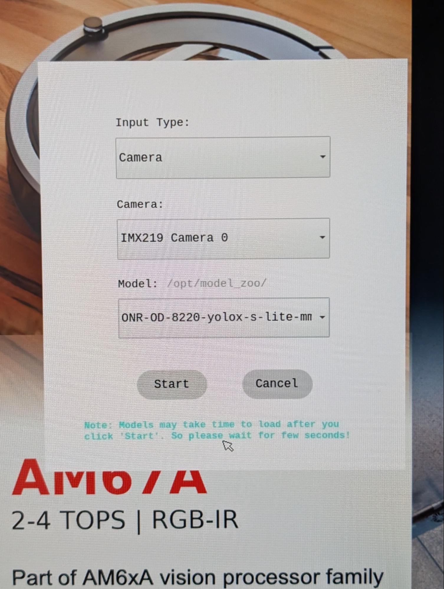

Use the mouse to select a demo in the side menu.
To test AI inference with the attached camera, click Custom on the left of the home screen. For Input Type, select Camera. For the Camera input, select IMX219 Camera 0 or your attached camera. Then select any vision model to run, and click Start.
Tip
If the camera is not listed in the drop-down, it may not be configured correctly. Inspect kernel logs at boot, and review camera configuration steps.

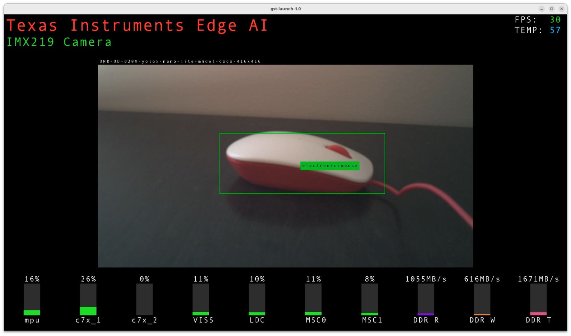

Congratulations! We are now utilizing an attached camera, image signal processor, and AI accelerator for a vision application. See TI Edge AI sample apps documentation for more details on the available demos.
Fig. 155 YoloX object detection demo#

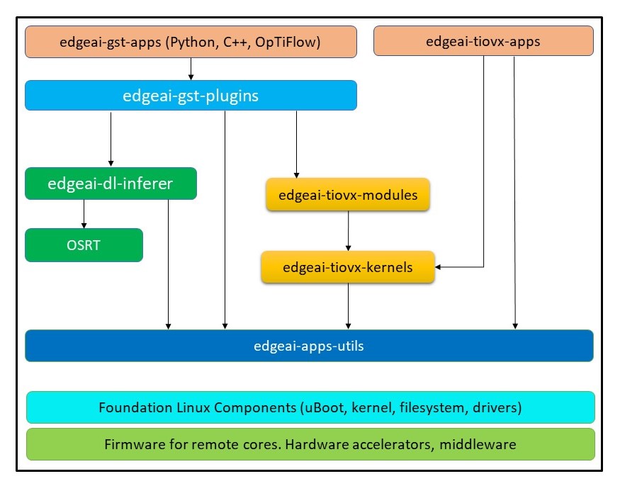

There are also a set of video encoder/decoder elements including v4l2h264enc and v4l2h264dec
that are hardware accelerated.
GStreamer provides a high-level abstraction for hardware accelerators so you can quickly create new vision pipelines, often without writing any code. The GStreamer plug-ins are built on a stack of rootfs libraries, kernel drivers, and firmware maintained by TI. It’s a bit complex, and part of why Beagleboard Debian does not yet support hardware acceleration to the same extent as the Edge AI image.
Fig. 156 TI GStreamer plug-in dependencies#

Object detection#
Let’s bring it all together in an object detection example.
This pipeline uses tiovxmultiscaler to create a branch for AI inference.
It resizes the image down to 416x416, processes the image with tiovxdlpreproc
and tidlinferer, and overlays the detections on the original image with
tidlpostproc.
Building on previous examples, it processes IMX219 with the ISP, rotates the image, and streams the output to a UDP server.
gst-launch-1.0 -vvv \
  v4l2src device=/dev/video-imx219-cam0 io-mode=5 ! \
  queue leaky=2 ! \
  video/x-bayer, width=1920, height=1080, format=rggb ! \
  tiovxisp \
    sensor-name=SENSOR_SONY_IMX219_RPI \
    dcc-isp-file=/opt/imaging/imx219/linear/dcc_viss_1920x1080.bin \
    format-msb=7 \
    sink_0::dcc-2a-file=/opt/imaging/imx219/linear/dcc_2a_1920x1080.bin \
    sink_0::device=/dev/v4l-imx219-subdev0 sink_0::ae-mode=1 ! \
  video/x-raw, format=NV12 ! \
  tiovxldc \
    sensor-name=SENSOR_SONY_IMX219_RPI warp-params="<-4096, 0, 0, -4096, 15360, 8640>" ! \
  tiovxmultiscaler \
    name=split_01 src_0::roi-startx=0 src_0::roi-starty=0 src_0::roi-width=1920 src_0::roi-height=1080 target=0 split_01. ! \
  queue ! \
  video/x-raw, width=480, height=416 ! \
  tiovxmultiscaler target=1 ! \
  video/x-raw, width=416, height=416 ! \
  tiovxdlpreproc model=/opt/model_zoo/ONR-OD-8200-yolox-nano-lite-mmdet-coco-416x416 out-pool-size=4 ! \
  application/x-tensor-tiovx ! \
  tidlinferer target=1 model=/opt/model_zoo/ONR-OD-8200-yolox-nano-lite-mmdet-coco-416x416 ! \
  post_0.tensor split_01. ! \
    queue ! \
    video/x-raw, width=1920, height=1080 ! \
    post_0.sink tidlpostproc name=post_0 \
      model=/opt/model_zoo/ONR-OD-8200-yolox-nano-lite-mmdet-coco-416x416 \
      alpha=0.200000 viz-threshold=0.600000 top-N=5 display-model=true ! \
    queue ! \
    v4l2h264enc extra-controls="controls, frame_level_rate_control_enable=1, video_bitrate=10000000, video_gop_size=30" ! \
    h264parse ! rtph264pay ! udpsink host=192.168.1.18 port=5000 sync=false
